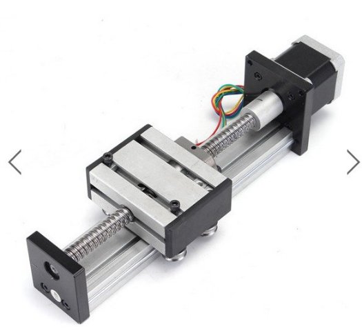

I recently did see this device on http://banggood.com :
https://www.banggood.com/100mm-Long-Sta ... rehouse=UK .
I'm currrently in England, so if the link does not work, use the search words: "stepper actuator 100mm" on the homepage of Banggood.
I did not buy it, but to me it seems to be a good start when you intend to build a punch for the 20-key rolls. On the website detailed information is present. On the Banggood site you can also find everything else you need for a punching machine.
